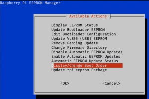

Raspberry Pi EEPROM Manager - rpi-eeprom-mgr
rpi-eeprom-mgr)Raspberry Pi EEPROM Manager (
rpi-eeprom-mgr) is a menu-driven front-end forrpi-eeprom-update.Available actions include:
- Display EEPROM Status
- Update Bootloader EEPROM
- Edit Bootloader Configuration
- Update VL805 (USB) EEPROM
- Remove Pending Update
- Change Firmware Directory
- Disable Automatic EEPROM Updates
- Enable Automatic EEPROM Updates
- Automatic EEPROM Update Status
- Display/Change Boot Order
- Update
rpi-eepromPackageAll actions include a confirmation prompt before being executed.https://forums.raspberrypi.com/viewtopic.php?f=29&t=283347
